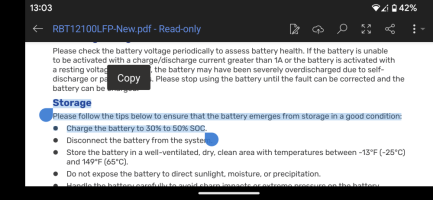

Also, I don't know what battery you've got, but see the image below. (Mine is lifepo4). The instructions for storage state the battery should be 30-50% if storing it. Which it kind of is, if it's not being used for a while. Might not be a good idea to constantly charge to 100% when not in use.

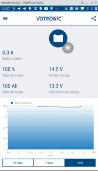

Got a few screenshots from the app?
I've got a drain of about 0.6 A (camera, tracker and WiFi router) so it drops to about 96% over night.
But then full charged by about 9 a.m.
