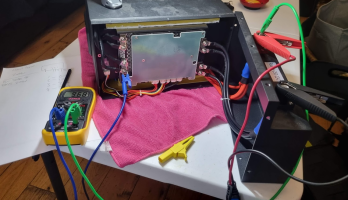

The new battery has gone the same way (i.e. won't charge). I had kept the first old 50aH Renogy LIFE04 they sent so I decided to take the lid off. The BMS had switched off in protection mode so couldn't charge the battery cells. They are arranged in packs and 4 in series to give the 13.6V nominal output (i.e 4 x 3.4v)
I then disconnected balancing leads then shorted out P- and B- momentarily which reset the BMS. Measuring each of the balance leads, I could see that one group of cells was 2.8v and well under the other 3 which were close to each other in charge state voltage.
Using a variable out power supply, I decided to top charge each of the cell groups individually to bring them all up to the same 3.4v voltage. After that, the battery worked OK.
Problem is with the batteries they are sealed with glue and if any of the cell groups go out of sync then the BMS will again cut off which is what has now happened with the second battery they sent me. I can't face another email and message table tennis with Renogy again! So, next possible solution is a 4S Active Equaliser Balancer Lifepo4 Energy Transfer Board (£6.59 from Amazon). This board arrives today so I will update in due course

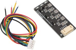

I will wire this in parallel with the BMS balance leads. This should hopefully keep the cells in balance and prevent the BMS going into protection mode again. This board will auto-top up any cell (where the voltage might drop close to protection BMS cut-off point) from the other cells in the array.

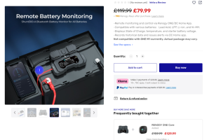

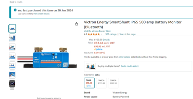

you could install a shunt on the batterys, , , that will give you a 0-100% fuel gauge style ,
so you will know what the state of charge is. . .
Renogy do one now. . .
i use the Victron shunts.
bother are good and essential for a lithium battery with no BT or way of telling what the charge is. . .
The Renogy & Victron one works with the APP on your phone.
its like adding BT to your battery. . . .
and the vicrton has the same. . .
they can also monitor the starter battery voltage,

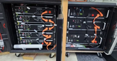

i do this with my Domestic solar batteries.
Ecoflow delta2 and other portable units,
as well as the lithium's in both vans.
FWIW. . .

I never ever let the batteries run low. Maybe more guilty of them sitting at 100%. I will try my cell balancer board in any case. Not going to buy shunts etc, I would buy a better battery before going down the shunt route
Currently top balancing each cell group after which I will wire the equaliser board in parallel with the BMS. This will then ensure that any discharge will be uniform across the 4S array. Using shunts and battery monitors would allow me to see in detail why the BMS protection is cutting in but the equaliser board will hopefully do it’s job and for £6 a cheaper option than battery monitoring with shunt. Shunt monitoring only confirms an issue I have. However once I get the batteries operating normal I will cycle them within normal operating parameters
