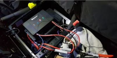

the fourth LED over ( that we cant see ) shows the battery type that the charger is set too.
the charge light is "green", indicating fully charged. . but thats a false positive if the charged voltage is set so low at 13.6v vs the 14.4v that the battery calls for.

some screen shots of the DC Home APP and battery settings would be good?
heres my install with the same charger from before - [Guide] DC-DC Charger (for leisure battery) -- How I Done It --
