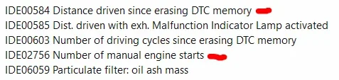

An interesting bit from from the log and the adaptations
which is normal value for DPF (diesel particulate filter) at about (25.000 km or) 15.000 miles. So the DPF has been replaced recently, this was one of things why I was curious when the faults were cleared last time to see if they would have coincided. Anyways, life expectancy for the DPF is approx. 200.000 miles under "normal" conditions.

The log was missing these two - didn't they show up? Just curious - no need chase them anymore :thumbsup:

The 2 red markers were missing. Maybe they got deleted after I cleared the faults.
