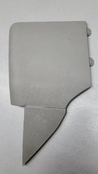

The last time I did this I ended up removing panels on the drivers side to get the fuse panel cover off. Crazy design.
I plan to modify the cover so it can be easily removed.
thanks im thinking of a hacksaw, how did you get it loose around the gearstick
The gearstick gaiter is just clipped in. Just prise it off.

NO don’t do that.
When I said I was thinking of modifying it I meant with a bit of finesse, cut in a way that’s hardly noticeable and with control and accuracy.
NO don’t do that.
yea, what think of doing it nicely, frustrations getting better

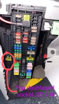

Thanks all, 1 fuse disappeared down under the carpet. I put the square fuse in for the upper dash socket but it still doesn't work, could it be on a different fuse?
Check 15a under the passenger seat
Dash aux fuse has been under the passenger seat since T5. Maybe it’s tucked under the carpet to make way for your swivel. Is it a double or single?
After a lot of digging on the fourm found it 12v socket upper dash
I thank that little fuse box you have on the side of the main one is an optional extra.
