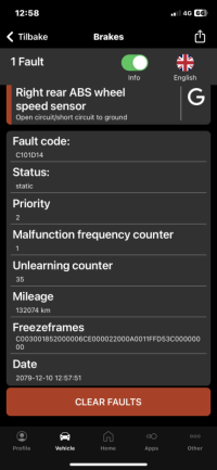

Don’t think there should be any relationship with my other fault codes?
-abs ,traction control -and tire pressure.

The ABS/Traction Control/Tyre Pressure faults could be related to a faulty ABS sensor or wiring. The Nav might use the wheel speed to indicate/verify that the van is moving?
Perhaps this is helpful?
I did an experiment with 0xF0 in ABS coding and discovered something interesting.
Basically when rear bidirectional sensors are coded for reverse operation it messes up accuracy of SAT-NAV on Discover Media. While on the move vehicle is always shifted from its real location and keeps on changing orientation.
This obviously proves that the speed readings from all four wheels are taken into consideration when vehicle location is being established. And the SAT-NAV doesn't rely on GPS signal only.
