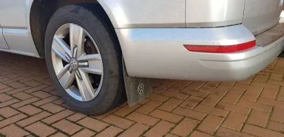

Generic universal ones can be made to fit with a little trimming and maybe adding an angle bracket to attach to the plastic underside behind the wheel arch. Dirty photo, but the spray pattern shows most of the muck isn't coming from the ground up. They mount in the proper place too, unlike the OE VW ones. Holes are in the arch liner and not the bumper.
