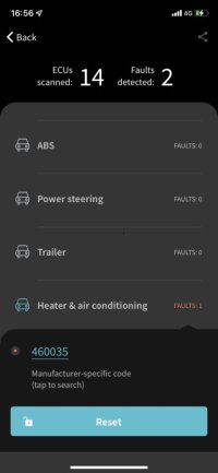

After way too long fannying about with checking fuses, I wondered if anyone could help me identify fault 460035, which I believe relates to me inoperative rear heater on my T6.1
Anyone able to shed any light in what I should do next?
Does anyone on this forum know if this code would mean anything to a vw dealer? I am wondering if Carista generates its own fault codes or if the code is the same that it would be in more professional diagnostic kit?

Probably nothing as dealers don't have listings of fault codes vs. actual fault. They would need to hook up the ODIS (the OEM diagnosis tool).
No, Carista doesn't use own codes. However, Carista seems sometimes to misinterpret the actual codes.
For this one I would use VCDS (or OBDeleven) to get the actual code with a verbal interpretation.
Possibly a misinterpretation - as Google doesn't find any occurrences of this code.
