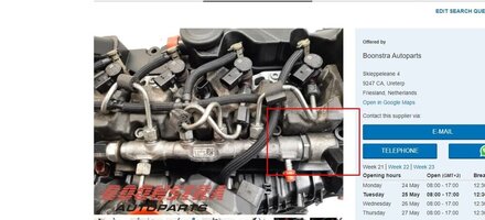

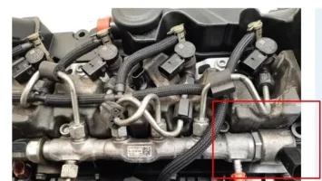

Be careful when going to order pressure sensor just by the Part number which is 04L130764B I have one on table and when I tried to screw it on rail it is 180° off did not ordered part based on car model just matched part number learning hard way
