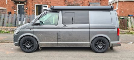

Joined the club :) Delighted with the fit of these. These are on a Caravelle 4mo with standard suspension.
Thanks all that have shared info and made choosing these fairly straightforward (hardest choice was colour - played it safe in the end).
For reference, I went for Pirelli Scorpion AT+ in 235/65R17 108H on these which are of course 17" x 8" ET35. As previously advised by others, my speedo is now a total match for gps through the range. Fitment appears tight in places but no rubbing whatsoever. Significantly more comfy than the 18's I had on too.
Centre bore on these is direct fit, however certainly my alloys are tapered seat so couldn't use the factory bolts.

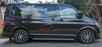

Being a Caravelle, is your suspension 20mm lower than normal Caravelle T6’s?

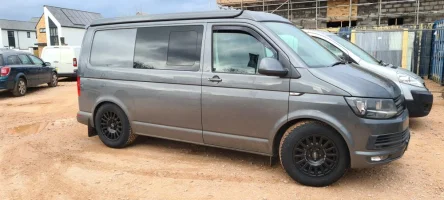

I'd be going for BFG K02's in 225/65 r17. Currently it's on the std 235/55 r17, and it's got 30mm lowering springs on it (so -10mm from a executive caravelle and -30mm from a std t30 t6.
As per your mockup they look great. The bronze, which is a very deep chocolaty bronze on the OZ wheels, really suits the black. The BFG Ko2 are quite an aggressive tyre so bear in mind the road noise.

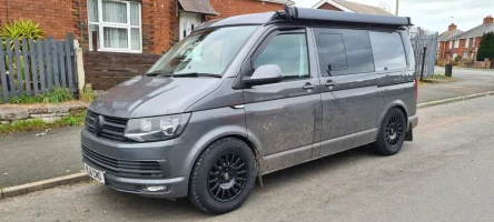

Great thread this! I have a T6 T32, LWB, Looking at getting OZ Rally Raid in gloss black, 17x8, ET35 with 235/65/17 Pirelli Scorpion AT plus 108. I have B14 comfort adjustable coil overs. Has anyone had any issues with this type of setup? Pics attached of current setup. Thanks Adam
