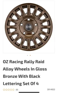

Morning, mine are Gold and not Bronze ! 50th Aniversery colour. They get quite a bit of positive attention, although the wife is not keen.Thanks!
My next question is colour…
They look much darker bronze on photos I’ve seen.
Are your photos more of a true colour likeness than eg demon tweeks photo attached?
