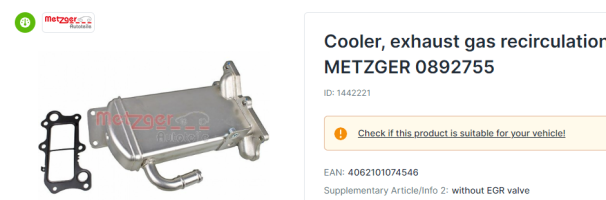

I assume it should look something similar to this:
but how to get part no for it?

Hi Fluff , I got a part no I think that is V29004521 but internet delivers nothing for it? Any idea on the gasket part. thx
I have managed to find cooler with gasket but I do not need the cooler just gasket
Hi, not sure whether this is an exact match but two part numbers are mentioned for gaskets here depending on the type of turbo.
neither works but thank you anyway. I have managed all to work using the old gasket. Works like dream no errors and no issue but egr was two days in bath :)
