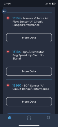

Sorry just reading this as I have a similar intermittent fault . When It happens I have code 13184 and p0322 . Sometimes engine cuts out other time is hesitant and revs jump up to 2000 on idle . Then when I clear code drop back down to normal . Would this also indicate crankshaft sensor ? Would you have a part number for this . Mines a 2017 5 speed manual .
Would I be right in saying crankshaft sensor or a break down in the wiring to this ? Is there a way of identifying the correct model of sensor before I pull it out so I can change it in one go ?
Thankyou for your reply btw .

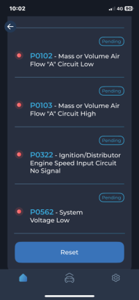

Been ok for 3 days back and for work at 50mph . Had to pop to tesco on way home this morning breifly so ( 20mph ) on leaving tesco after 20mins stop car played up on 2mile journey with coil light coming on just before I got home . Plugged carista in got following codes . Anyhow cleared faults restarted - seems ok but does sound rough , could egr be causing all this ??
First fix the issue with engine speed sensor (13184). The engine can't run properly without knowing it's timing accurately.

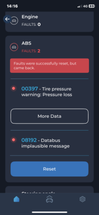

This may sound daft but I have an abs alarm as well before for this arose telling me loss tyre pressure , I have put all the pressures the same yet it will not reset and very occasional , once every 2months my needle speed differs from my digital speed , weird .
Carista won’t reset it and if I try resetting using the button inside the glovebox , which I’ve used before, it doesn’t even try to reset it
Reactions: mmi
Carista won’t reset
Yes, I think Carista simply isn't capable of doing it because only clearing fault code memory isn't enough. Need to initiate the tyre pressure learning process - via ABS controller Basic Settings.
Sounds like the button/wiring is faulty.
Checked button all working ok . I found a different way to reset the abs sensor by using the Tpms function in the service menu , which cleared it and the dash light has gone off but when you scan the ecu the fault is still in there ?
Reactions: mmi
Correct. The fault code memory is a different thing - the fault code should clear now with a diagnostic tool.
I am being quoted £115 for crankshaft sensor and £90 for cam shaft from Volkswagen .Does anybody recommend a as good replacements that will be exactly the same or is it not worth taking the risk ?. ( I’m getting crankshaft code on carista but mechanical is getting random readings on camshaft so getting it checked somewhere else ,then will order correct one )
Code on Carista is P0322 . Anyhow went to a different mechanic today , no issues on way there, when he plugged it in no codes apart from EGR( 15560 ) Checked camshaft and crankshaft sensors readings ,working as they should . Drove around for a bit and then drove home and no issues at all . He seems to think it’s all EGR related . Will try adding addiditive to fuel tomorrow and go on a long motorway drive and hope for the best …
