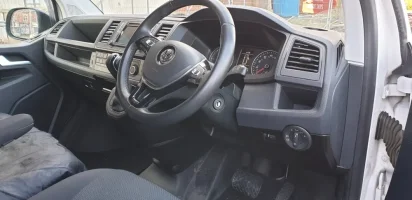

My efforts with the Buzzweld, finish is pretty great no complaints there and it is hard to scratch off, but obviously is way too dark. I've lived with it about a week now and dont hate it as much as the grey originals, but not too pleased that it doesnt match the top. Not decided if ill keep it on yet so kept grey set for now20200305_083156.jpg 20200305_083203.jpg 20200305_083208.jpg 20200305_083214.jpg
You've got a great finish there mate.
I didn't get as far as doing the lower dash but more the apillar upwards as the contrast isn't as oblivious with the seals being black.
I actually quite like the dark lower light upper, hoping to do the lower b pillars next but may carpet instead i think itll get scuffed alot
