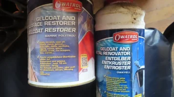

Last of the big spenders - just bought a 500ml tin of Polytrol colour restorer.

@Bav , I heard this product could be used on a pop top to get the shine back, thoughts?
Not tried it yet mate, but I regularly watch the YT channel "Chop's Garage" - a west country car dealer specialising in the sale of sub £5k cars - he isn't sponsored by them, but he swears by the stuff for restoring the colour and shine of any black trim and he even uses the it on paintwork. By the results he gets, I'd say it'd work well on a pop-top.
For Polytrol results have a nose at this…..

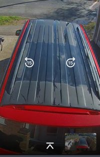

One of the guys on another forum has just posted a warning on using polytrol after messing up his black poptop and making it look even worse .
I think he put it on too thick plus it looks like its reacted with the polish that was possibly on the roof previously.

I saw similar in the comments of the video posted earlier. In the video it shows his roof fully mat and quite uniformly shagged. Mine still has gloss in places so along with the waxing etc I’ve already done I was wondering I think could be an issue.

There are 2 different products - I wonder if he has used the wrong one. There is a restorer and there is a renovator, One is just applied the other is applied and then washed off.

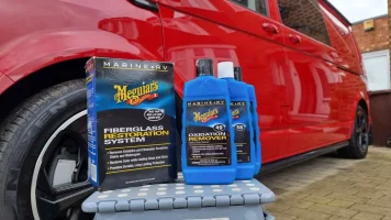

Mine has gone flat and dull again so the Meguiar's only lasted a few weeks/months. Will be investigating a carbon fibre look wrap for next year.
