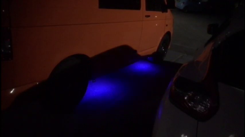

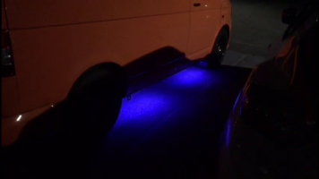

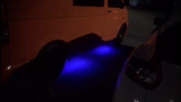

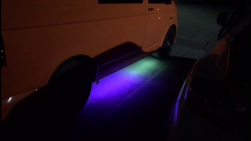

Done mine this week, but made them myself out of 24v rgbic led chaser strips, fitted into led c channel lengths which were fitted under van first on both sides to house the strips (managed to get 2m either side). Either have them on permanent (as they are app controlled with 228 combinations incl sound activated) or simple switch to switch over to timer control, so they come on when door unlocked and go off when locked (or when key turned in ign) bit of a fiddle but got there in the end, cant upload video on here but a sample pics attached.
