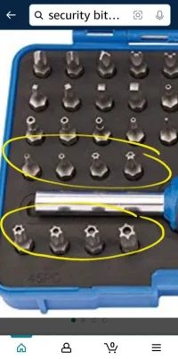

Looks like a security torx bit.
To might be able to get that out with a suitable size flat blade screwdriver.
Doesn't feel or look like a torx screw?
What a royal pain in the arse.
So if the rear fog light switch lights up and the dash rear fog lights up then the fuse should be working right?
Hmm... Looks like a 5 point.
Maybe a security Allen bit may work?

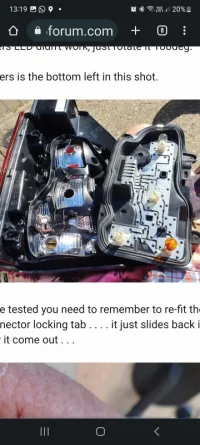

You don’t need to undo those screws, any lamps that are changeable can be removed straight out the back without taking anything more apart
Factory LEDs will have foglights on both sides so unlikely (but possible) that they have both gone at the same time ??
Also are the led bulbs even replaceable? Can't find a replacement online as of yet?
No,
AFAIK... The whole light unit needs replacing.
