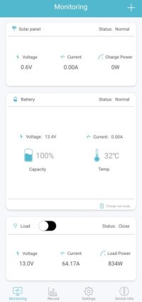

interesting just got into the app and found this warning regarding over current protection
So assume that means the alternator is pumping too much out?? Anything you can do to control that, run the battery down a bit or something??

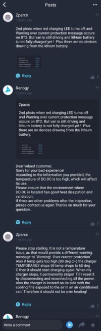

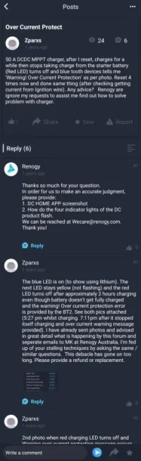

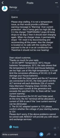

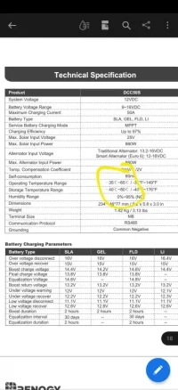

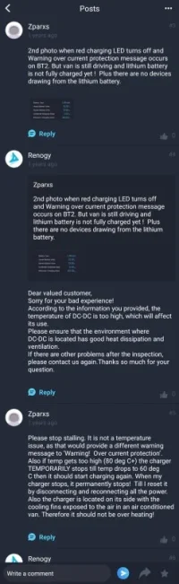

There's a forum in the Renogy app, someone else with exactly the same issue, Renogy have chipped in and seem to think it's do with operating temperature...doesn't stack up though, temp of battery and charger are both about 30c and the operating temps in the manual claim to be up to 65c...

you have showing 64A here which has triggered the Alarm.
the unit is 50A , , , but can pull 60A max on its input side,
due to volt drop over a longer cable run.
yours is showing 64A on the imput side, so its triggered the fault.
