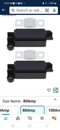

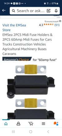

The destructions for the Renogy 50a DC to DC MPPT indicate I'll need a 75a and a 65a fuse - can someone point me in the right direction for these please?
The cable from starter battery is 25mm2 which I believe is more than enough.
So I assume I'm ok to go for 60a and 80a rather than 65a and 75a ?
