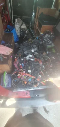

I've chance off a full 4wd system
7speed dsg box / transforbox / 4 driveshafts/ te .propshaft. rear diff . Abs pump .dsg remote/ cluster
From a t6 transporter .
Wondering first if the mounts are there stand on a early t5 ?
Wireing wize to keep it basic .
I assume I'd need bcm as its got cangateway built in ?
I didn't realise the lwb body pan .is didfernert to the 4motion version ( ie no rear diff mounting points )/ handbrake cables differnert length and mounting points .
I've a 2018 t6 4motion dsg set up. With diff lock Which I'm going to attempt into a old t5 .
Regards modules I've the matching cluster .Key.bcm.abd pump .from the donner.
I've located a t6 dsg box loom ( looks same as t5.1 )
Located a t6 abs loom
Rear diff loom
Dsg selector part loom ( t5.1)
I assume t5.1 / t6 are same bcm ?
As was going add a full t6 loom but most get damaged via breakers. . Any further advise ..on wireing and mounting points

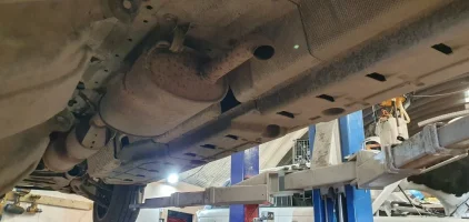

For mounts, this is the underneath of my T6.1 LWB with 4Motion. It’s a random bit of video I did for reference before I took the trays off to fit heater and water, but it shows some of the mount points.
That's chuffing brilliant . .gutted standard chassi dosent have any mounting points for the 4wd
