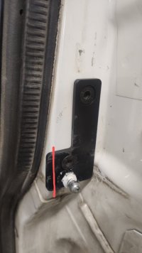

A friend who is a bit more handy than me owes me a favour, and has started fabricating the brackets, however, he has asked me to find the measurements indicated in red....

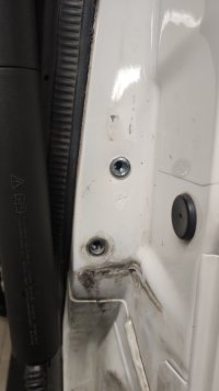

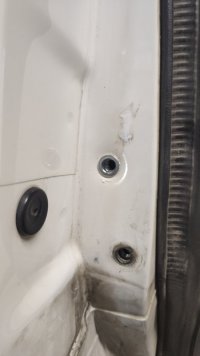

Having looked at the van itself, it doesn't look like the measurements are particularly critical for the two mountings - it looks like you need to drill them out in the van yourself anyway. It looks like the existing hole for the stud can't be reused for mounting the bracket. Can anyone confirm this please? :D
For those who have drilled their own holes for the bracket, can you actually get to the back for a nut? Or is a rivnut or similar a sufficient enough fixing for it?
The mointing points might be different on t5, I don't know. Maybe others can answer that.
Regarding the measurements on the bracket, I could check this at the end of next week.

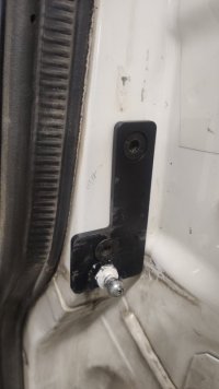

Below is LHS bracket that worked for me, obviously RHS is a mirrored version.
This option is for people who are not going to switch to 7E5 tailgate and want to keep their existing 7E0 tailgate and are willing to also implement modification to the tailgate itself.
Tried to fit the bracket from this drawing, and the door didn't close up to the end (sad)
2-3mm lack from tailgate to rams on my T5.1 car
Seems that 4mm bracket is extra fat. I suppose 2,5mm metall instead of 4mm will be fine. And bend nearly 5-6° instead of 14° or no bend at all.
Or maybe a little mod of tailgate's body itself required? @Robert @Deaky please advise
Thx

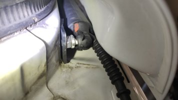

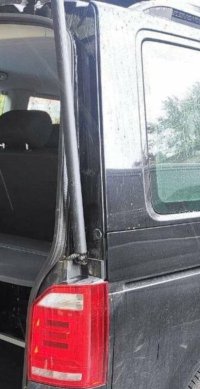

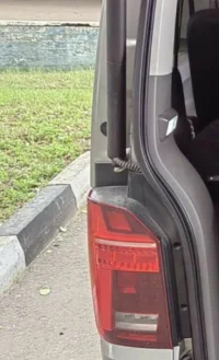

The photos below show electric rams mounted on a custom made bottom brackets on a T5(2010-2015) --> AKA T5.1 or T5.2 .
View attachment 186339View attachment 186340View attachment 186341View attachment 186342View attachment 186343
By those photos I suggest that:
1. The bracket is thinner. Metall must be 2,5mm (maximum 3mm)
2. The bracket is straight, with no bend.
3. The ball stud itself is soldered to the bracket with no nut in the middle.
4. Width in the bottom side must be 4mm less (see red mark on my photo)
Beware not putting a small bend in the bracket. One of my rams popped off the ball and smashed my tail light.
  • Wow
Reactions: mmi
That's the best outcome. I have had both pop off and I can only imagine what would happen if my kid was under it. Up to this day, I have not fully completed this project due to my fears about my children :-(
And to be clear, electric tailgate retrofit can also be implemented on T5(2010-2015) with original T5 tailgate.
Home made bottom brackets are required instead of (7E5827436B, 7E5827435B) and there is absolutely no need for any modification to the T5 tailgate itself.
Unfortunately no success with t5gp tailgate 7E0827025F
Not enough space even with no custom brackets - when rear door closed the ram is jammed and there's no gap for it able to move. I've prepared bottom brackets of 3mm metall, and tailgate not closes with them at all - lack about 3-4mm., electric ram hits tailgate boundary.
Seems that tailgate itself needs to be modded slightly too. Or some additional secret with upper mounting points. Hope you know how this mystery was made
