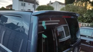

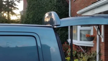

@Amped , great van but you're no David Bailey with a camera !!! ;)
Lacking in the sleep department today only had 3hrs kip and just about to go back in for another shift. Will take some better Ines when my feet touch the ground
Apologise for the crap pics, it's a black metallic, was going to get it dipped but it was another 230 and wanted it for run the ring on 25th.
