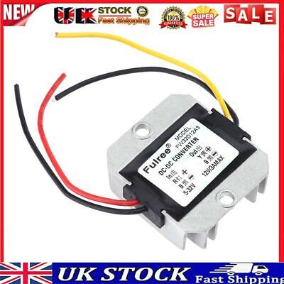

I bought one of these for my LED lights after reading about using a 12v - 12v voltage regulator might be a good idea for them….
