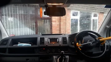

Screen - Excessive moisture
Thanks DXX, that's a great tool. It might take me a few days to get some results but it makes total sense.
Well this morning was totally different. A warmer but rainy day and the inner screen was dry as a bone. I can only conclude that it is simply down to lower temperatures with no decent sun light.
I had moisture in the same area as your pics. Water was getting in around the grommets where the brake light cable comes in. Took light fitting off and sealed around grommets. Also removed rear bumper as water was also getting in around the edge of the black slam vents - again sealed around the edges of vents and the area behind rear wheel arch is now dry.
Thanks, that's good info. Thinking about it, when I've had the back lights off, the grommets are a bit flimsy and a lot of water can run behind the light clusters over time. Massive learning curve already and loads to go...
Is it just the windscreen that gets really wet? Or side and rear windows as well?
Normally it's just the windscreen but occasionally the drivers window can hold moisture aswell. The 2 side windows and the rear door windows are boarded up at this time of year mainly for security reasons, plus they are within the 'insulated' area.
Its similar to when you sleep in the van with limited ventilation. (I suspect that with a pop-top, even if not fully elevated, you could crack it open a smidge to vent). I'm going to try a few ideas that have been suggested. In the grand scheme of things, I don't mind wiping the screen as I'm never in a rush but until Spring arrives, I cant see me getting to the bottom of it during winter - I'll just manage it.
The screen is totally clear this morning but it is 7° today and mild.
