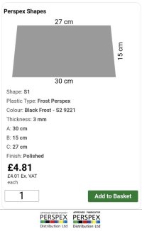

I'm considering these folks
As one of the bespoke shapes would work I think, these aren't accurate measurements just estimates to see rough prices. This is 3mm frosted black perspex.
My thinking is to get a couple of knurled thumb nuts and attach a bolt to a couple more strips of either wood or perspex to form a locating clamp either side.

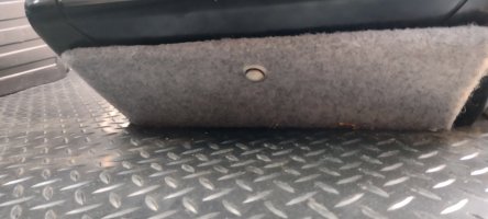

I've carpeted a piece of ply to match the front profile of the seat base, then fitted an evo type push button catch that latches behind the inside top front of the base - you have to push it down quite hard into the matting to get the catch to clear but it works fine
I'd not thought of the catches, and I have two in the kitchen pod. That deserves some though indeed... :thumbsup:
What sort of thickness ply? I've got some thin ply offcut from lining a shed in temporarily but it's a bit flexible.

That's a nice job, thanks a picture explains a 1000 words :thumbsup:
I guess the other advantage of carpet is it stops the rattles and gives a bit of sprung fitting play?
