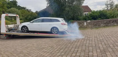

Just had the local breakdown guy round to look at the car - job was handed-off by AA (presumably due to location).
Injector 1 was "weepy" and when it was disconnected (whilst the engine was running [like a bag of spanners]), it had no discernible impact Also tried disconnecting injector 2 and there was a noticeable deterioration with that one. Given the repair cost is probably not that bad, it's possible that the old girl will live on.
Anyway, now arranging to get recovered to a garage local to home and looking forward to 5+ hours of chit-chat with recovery guy. :rolleyes:
Could be as simple as a fuel filter (near the tank) blocked, or the LP fuel pump failed

Back home now after Wednesday's tortuous 8-hour tour of A1 service areas (Washington, Scotch Corner and Wetherby) via a series of different flatbed trucks (now I realise why the AA's National Recovery service used to be called Relay!).
Local mechanic has confirmed AA's diagnosis of fooked injector on cylinder 1, which is good news in terms of the cost of the fix. However, given that I'll never be able to trust the car on a long journey again, it deffo needs to go and the search for sensible replacement begins in earnest.
Car is now back from repair. It actually needed 2 new injectors, but I got them to replace 3 (the fourth one was replaced at the end of last year, so all 4 are now new). It also needed an oil change as it was badly diluted with fuel - this pic shows just how much unburnt fuel was passing through.
