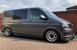

Hi All, new to group and new to the world of Banded wheels, just bought these! They were removed from a Land Rover defender they have been banded to 8.5 front 9.5 rear! My question is what type size would suit! Van will be lowered on coil overs! I was shocked how wide the wheels were when they arrived ¯\_(ツ)_/¯
Rear wheel measures nearly 11”s wide from outside to outside seems massive! The seller says I can fit 245 wide tyre! Not sure what’s best..
I had the same wheels in same widths as yours on mine and ran 235/45 18's. They were only 98Y load rated though.

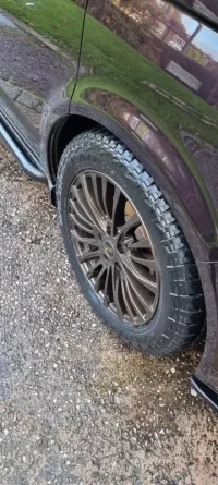

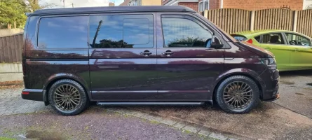

Hi, mines a T6 T32 running Wolfrace Munich 18’s (8.5J and ET 42) with 255/45/18 tyres and Bilstein B14 Komfort Coilovers kit. As with many others before lots of dithering between 18’s or 20’s! But, have to say ride handling and comfort of the van has been transformed and am very happy with how it looks as well!
