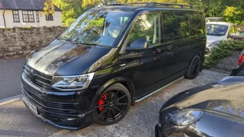

@The Van Cave can help you here.Are these dimensions going to give me issues with the side door? Van is lowered about 40mm on STX
Hi these look really nice what suspension do you have?

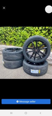

Looks good what tyres you running ?I’ve just snapped these up, can feel they’re heavier when driving of course but don’t think it’s that bad. Tyres seem very quiet compared to the crappy commercial ones I had on the Devonports
They have near new 265/40 Goodyear Eagle F16’s on, which is pretty much why I bought the wheels!Looks good what tyres you running ?

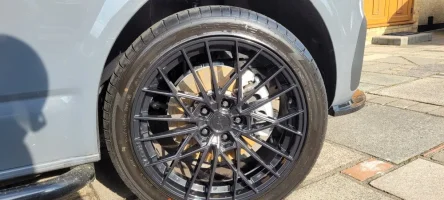

No rubbing on arch or liner? What offset?
No sliding door catching or wing rubbing? Could I push the fronts to 255 at that offset?Inovit torque.
Front 8.5x20 ET35 245/45
Rear 10x20 ET40 275/40
All T32 rated and a great price.
Inovit do loads of great styles in 20 at 880 kg load, staggered or not.
Koni/H&R coilies about half way down. The ride is sublime!

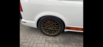

Are those 20x9 with ET 35 front and rear? What tyre sizes?It’s all about the offset of the wheels, mine are 35 offset on the front and drop under my arches easily, the rears are tighter but there is a 1mm gap between the rim and my arch when fully aired out. See image.
