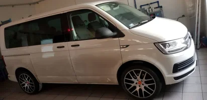

Version of my multivan T6 - T30
Hello,
I'm just freshly fitting the 20 "rims back ET35 9J front ET40 J8,5, the tires are uniroyal 275x35. The front works nicely at full turns, while the rear at the final stage of opening the sliding door gently rubs against the tire ... Any ideas? Rubbing is not big, the door opens, but over time the sliding door trim will not look good ...
I know, in a moment I will get a missile that the car is dirty - but I have poor weather conditions at home, so the car is dirty ...
