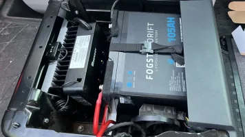

Roamer seatbase, 230Ah of screaming diesel power... sorry, lifePO4 power, oh and the same DCC50S and they're both under the drivers seat.:thumbsup:
Nice! I was looking at this battery that's the same AH but a tiny bit smaller. Great to know they'll fit. Did you have to deal with any existing underseat wiring for the earth?
There's been a bit of fettling making sure that no wiring, factory or add on ran under the battery and clearing a bit of the rubber mat to gain depth.
The top back edge of the Roamer just slipped under the back edge of the actual seatbase frame so a simple L shaped bar across the top front edge of the battery holds that firmly in place.
The DCC50S is held in place by the two slots I cut into the seatbase frame, this is just a sliding fit with the seat holding that in place when bolted down.
As for additional wiring you can see most of the install there although there is a Sargent EC160 in the wardrobe but that was part of the original conversion by Redline and is pretty much a glorified fuseboard for the EHU now.

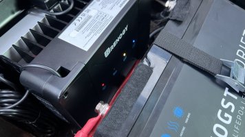

Finished off installing the CTEK DC to DC charger under passenger seat to replace OEM SCR (T6.1 with factory leisure battery). Was going to fit Victron after some Forum recommendations but wanted ability for Solar and the CTEK is one unit, plus I got a great Trade price on one so went for it. Also fitted Victron SBP.
Trimmed off surplus plastic from old SCR holder etc to free up space.
Fabricated/adapted some brackets for CTEK. All fused with 30 A midi fuses as per instructions. New cables where required. Applied loom tape to existing cables too where it was lacking from build. Cables all secured and crimps heat shrunk to look ‘Factory’. Took a while to route the cables to my satisfaction but happy with result.
