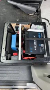

Not a single build thread, but posts in various leisure electrics threads and the ‘WHYDTYVT’ thread. Mine was an upgrade to lifepo4 plus solar which also meant replacing the existing, but unsuitable, CBE kit and taking the opportunity to relocate things from the rear wardrobe.
In short(ish), it was a rewire from SB to new Victron DC-DC, Fogstar 105ah battery, Victron shunt and Ablemail AMT12-2 under the passenger seat.

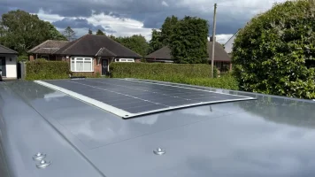

Cable then runs to the rear wardrobe to the original CBE fuse box to distribute the power to lights etc. The Victron MPPT and solar isolator is here as well as that was the easiest place to route cables from the panel. The panel is a Renogy 200w flexy that I have Sikaflexed to the pop top with a 5mm gap underneath. I put PPF on the roof first in case I ever need to replace the panel. Cables route via a Scanstrut gland through the pop top (outside the tent) then into the tailgate cable seal then to wardrobe.

If I was to do it again I’d use the Victron XS DC-DC as it runs a bit cooler but that wasn’t available when I bought my stuff.
