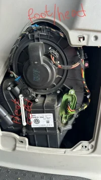

Following advice on here I dropped the headliner at the rear where it meets the D pillar air duct and found the small servo motor for the control flap which swaps between side and main vents. The gear wheel had snapped off presumably because the motor rotated too far. It causes the air flow to default to the side windows only and shuts off the main air vents.
I got a replacement motor which seems to do the exact same thing, before connecting it is set in one position (on the wooden board in the photo) and then it auto rotates, but the position it goes too (shown with the white background) is beyond the physical stops of the gear which causes it to shear off. I have opened the motor to manually change the position but as soon as I connect it to the van it auto rotates again to precisely the same position, it must have an optical sensor inside to determine the position of the gear wheel.
