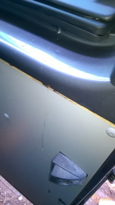

I am over near Falmouth, I only noticed it yesterday... Carrs are the dealer I will go over to.. trying my best to like this van.
They will want to video the window leaking...they are aware of the issues as when I went, they booked it in for a replacement under warranty before they had even inspected it! We had an issue with access because of the kitchen conversion, but had a new window within 3 days!

it's a combi but it's fully carpet lined and its soaked.. thanks for the info..

That's just like mine was. I booked it in with my local main dealer who did a water test and they then ordered two new windows. Booked in again a few days later and had them both changed and collected the same day. That was about 5 weeks ago and so far so good. No sign of any water. Good luck with yours, but I expect the only way is to have replacements.

At the moment its parked at the dealers. VW are refusing to any more work under warranty unless its a new non opening window replacement. I'm not having that as I want opening windows as that is what I purchased.
Its had several krytox treatments.
The originally windows taken out and then re fitted.
Then new inner slide windows.
Its never had a new complete window, and that's what I think it needs.

This issue makes me really angry, the mix of responses from different dealers from amazing to downright criminal! VW know there are documented issue with the sliding windows which effects about 2 in 10 window units:
1. The small drain holes in the slider groove just not man enough (just a poor design) and then, 2. the lower slider rain becoming adrift from the glass (failure in the bonding material) which then allows water to bypass the drain holes along the bottom edge of the glass/lower rail.
