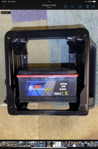

I sort of get it. Thanks for reply’s. I need to order some parts i think. Need a semi flexible solar panel as I’m going to stick in to the roof, a solar controller and any wiring I will need. When I originally converted the van I used travel volts for everything and it was all so easy with everything he supplied for me. What should I order now and who do I go to, can anyone recommend someone please. Any help or advice would be much appreciated. This is my leisure battery that is connected to the Ablemail b2b charger. Many thanks.
