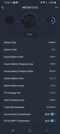

Can I test how many watts are coming from one panel with a multimeter me thinks there not 100w as advertised
Yes.
Put a multimeter on the 10A current setting. The put direct across one panel.
The current you read will be the I Max.
Or connect the panel leads together and use a clamp meter to get the Amp readings.
What Renogy charger have you got.?.
They do three 50A charger versions, so it depends on what one.
Fyi Renogy make very good pv panels.... You can't go wrong with them.
