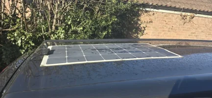

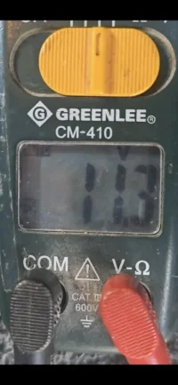

The solar panel on the roof is wired to the CTEK and I have put a multimeter on the pos and neg of the CTEK solar and, as its a sunny day today, got a reading from the solar panel of 11.3vdc, but this then drops to 3.9vdc randomly.
