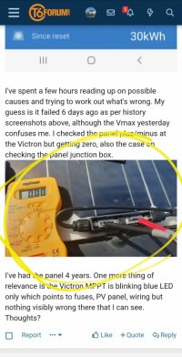

I've spent a few hours reading up on possible causes and trying to work out what's wrong. My guess is it failed 6 days ago as per history screenshots above, although the Vmax yesterday confuses me. I checked the panel plus/minus at the Victron but getting zero, also the case on checking the panel junction box.20240509_152625.jpg

What does your MPPT show for voltage and amps coming into the charge controller?
Blinking blue on the Victron just means there's not enough PV to allow charging, which doesn't help really.
If you can disconnect the panel via the MC4 connectors or the input into the Victron, then test the open circuit voltage and the short circuit current, this will tell us if your panel is alive or dead.
Edit: just seen your last picture - that does look like dead panel. :(
Reactions: MrD
Try this test again with the panel disconnected from the victron mppt.
If you still get 0v then it's looking like the panel is open circuit/dead.
If you get voltage, around 18v odd then we can look more into it.
But the screen shots look like a failed panel.
Yes, so that's the open curtain voltage, only tested with nothing connected to the panel.
Test the Amps in the same way while it's disconnected.
Panel might be ok then? Have you checked the fuse in the MPPT? To the left of the inputs on the bottom (normally, depending what MPPT it is).

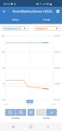

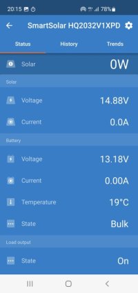

I've no meter to check amps (working away from home). Solar voltage down to 15v and the battery voltage up and down.
But battery sense monitor pretty stable, switched a few things on to see how it would affect solar draw.
Victron LED's were steady blue, then steady yellow, now back to steady blue - bulk/float/bulk.Victron app not showing any rise above 0W.

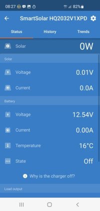

A couple of weird things going on...
You might be onto something there - MPPT disconnected.
So either the panel is faulty and unable to deliver any amps to the mppt.... Dropping voltage to zero as the mppt loads the circuit.
Or the mppt has a short on the PV input... causing volt drop across the panel.
As above you can try a Amps test on the panel and see what you're get.

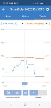

I checked again this morning with some, weak, sun on the panels. I've left fridge on while it's parked up at work and check what happens.

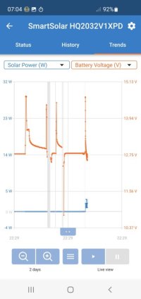

I also note this :
Those greyed out periods, what's happening there? My other thoughts are that
1. The battery is nearly always at a full charge, I'm not a heavy power user and have a DC-DC charger as well.
2. Yesterday was probably the warmest day of the year so far, the panel was hot, hard to keep my hand on it, it's fixed directly onto my poptop with no airgap that I can see.
3. Connections into the MPPT are untidy and I will get them crimped for a cleaner connection.
4. There are fuses in the system but on the battery end, but going by above all is okay in that regard.
5. It might be a 160W panel but I think the highest I've seen it is maybe 60W.

Looks like panel has failed.
Micro cracks on the busbars.
Sun heats up panel causing thermal expansion.
