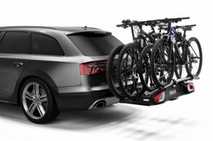

Quick question @Qnapper - is the above reflector panel required for bikes on a tow-bar-mounted carrier? I'm guessing yes, but would be good if you could confirm.
Required for any bike carrier (or anything else for that matter) that extends past the rear of the vehicle. Not required in France, different ones needed for Spain/Italy etc and limitation in Portugal on how far it can extend too (which could be an issue with the VW 4 bike racks as they stick out miles!)
Edit: this is based on my research but may not be current or accurate so best double check.
