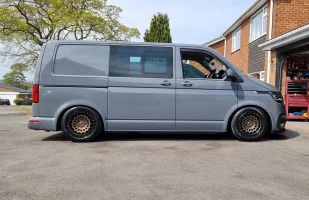

I find it's perfectly fine, I get no scrapping but I'm always careful anyways. I was running 18" sportlines with 255/45/18 tyres and that was ok
What do you think in reality the highest setting is I want to lower mine but only a bit for now
They come roughly 70-100mm lower than standard out the box. I'm currently 360mm from centre of the wheel to arch lip
Cheers don’t know if that’s to much for what I want but the ability to drop lower would be good

Nice - bronze on grey.... great combo!!!
Yet in your mind you'd think it wouldn't.
I was actually quite surprised how well the colours went together, because Pure Grey is one of the most awkward colours to get a wheel to work with, that isn't Black, as Mark will confirm.
On a side note with Solow's, the lower end of the adjustment is proving to be rather impractical. Yeah it looks the nuts and it's not actually that far off Air lows, but as a static daily work van, it's getting stupid now.

This is what height I have the KW at and hopefully the solow won't be too much lower but a little more comfy...?
Looking at that photo solows will be way lower, even on the highest setting they’re low. Look on solow website there’s plenty of images with vans on they’re highest setting.
