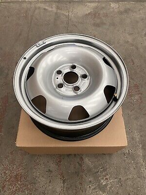

Some more options for steel spare wheel.
Or
Which I could fit a 225/65/r17 Falken wildpeak to. (225 is probably the max for a 7J rim).
Both the above options would need powder coating Matt black,
