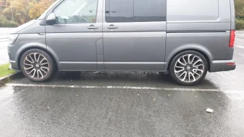

I put the Stance coilovers on in Early summer and although i have nothing to compare to..they seem pretty good. Done about 2k miles on them so far..but have noticed a slight harshness over rougher ground but i suppose thats the trade off for looking good and going lower. So correct me if im wrong here..
If i raise the van up abit..would that allow for more travel thus a softer ride..or should i swap the springs out for harder ones..like in the previous post. Im doing a highland holiday in dec..and my inlaws will be with us..so i was thinking with increased weight..maybe van would be heavier..thus even more harsh over rougher roads. Also i will be buying a pair of autosocks in case it snows and if theres more room over the tyre it be easier to put them on...
Thoughs?? Thxs.
Thoughs?? Thxs.
How low does it sit now?
I have transporters sitting that height and they are really comfortable , but I use top quality equipment ( not coil overs either ) . You are right though lifting will help a bit ! the valving in the Stance is probably quite basic ( to get to the price point ) and that you wont be able to do anything about that . Fitting heavier duty springs might not be that simple unless Stance offer such parts ??
