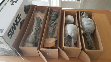

After much forum reading, debating and beer it was time to order a set. I had a 10% voucher on fleebay so I took the plunge and managed to pick a brand new set up for £250! Come on, £250 for coilovers? Really?

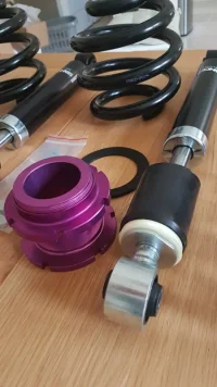

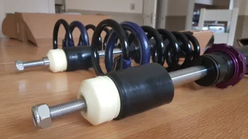

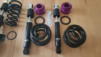

So they arrived the following day I might add, initial impressions.... For £250 its ridiculous. The quality is fantastic, seriously, these equal the van slams, Tein, BC... The list goes on.
Fitting, well... It wasn't a big job ( I am fortunate enough to have access to a 4 post car ramp) even if I didn't have a ramp this is still very easy to do on the floor. All you need is a set of spring compressors and basic tools really. The only thing I would say is that it would have been nice to have some instructions. Its not the end of the world, they are a fairly easy to fit item but I would have thought there would have been something.
They do provide a C spanner but only the 1?
