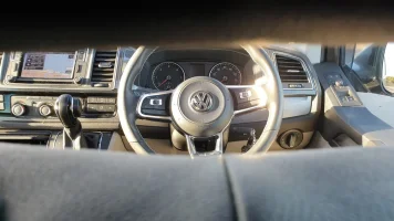

@Superowls you steering wheel looks superb, very OEM+ Did you replace the original airbag? My understanding from this thread is the steering wheel needs two metal catches to use the original airbag, but your new wheel has three plastic catches as seen on another version of the wheel.Got mine back from Royal Steering Wheels today
Very impressed with the service and quality, definite thumbs up
