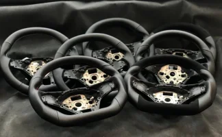

R-line steering wheel with paddles and all working with ACC etc on a December 18 T6 Highline
@BeePee For those who have fitted the Golf R 7 steering wheel, have you managed to get the buttons working, or have you swapped the buttons out? If swapping buttons which buttons did you use, as I'm presuming the original T6 buttons don't fit the Golf R steering wheel? I'd like to fit a Golf R steering wheel, but would like to have red illumination. Is this possible?
@Superowls you steering wheel looks superb, very OEM+ Did you replace the original airbag? My understanding from this thread is the steering wheel needs two metal catches to use the original airbag, but your new wheel has three plastic catches as seen on another version of the wheel.
That's for the comment pal, I'm happy with it
My steering wheel is from a Polo 6c and the original T6 airbag is a different fitment
I bought the Polo wheel complete with airbag to avoid any issues
Works out more expensive but then you can sell your wheel complete with airbag to get the money back
In the end the wheel cost me nothing, I just paid for the re trim
So you have red buttons all working?
I was fed up messing around, sold the GTi wheel and bought a brand new one ready to install straight on from Germany, by the time I sold the original wheel and the other GTi wheel the swap has cost me about £100, result !
