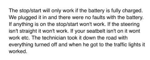

Ok so reply from the garage this morning. Anyone else van work when the steering wheel isn’t straight? This is the reply below.

I will give a few of these things a try next time I am out in the van, but your dealership sounds like they need some training in after sales service.
Well, I have just been out in my van and can report the following:
Stop/start works with the wheels turned
When I put it in park it worked
When I removed my seatbelt it didn't work, however
When it worked and engine was "stopped" I took my seat belt off and the engine stayed off.
So essentially don't believe anything the dealer tells you.
