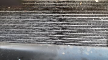

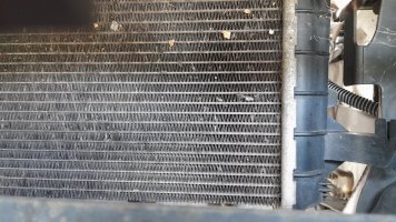

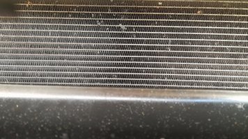

Some pictures - perhaps the same

A few pics may help?
The mechanic showed me the damage yesterday and it was wet. However it is not so clear today. Would the wet be water?
maybe he sprayed soapy water on the rad to see if it was leaking ?

You will either have an intercooler or a radiator for the charge air cooler behind the grill.
Although they look the same they are very different;
If it’s an intercooler; internally it will have the induction air with some oil carry over, if it leaks there will be an oil stain.
If it’s a radiator for the charge air cooler; internally it will have engine coolant, if it leaks there will be a water type liquid, probably pink and it will have a distinctive smell.
If it is this radiator unless you loose all of the coolant you shouldn’t have any limp mode symptoms.
I suspect you have an intercooler, in which case if there is no oil stain on the matrix I doubt it is a significant leak.
Possibly another component is leaking loosing boost pressure

Thank you for the explanation.
It is a CAAB924523 engine which I have been told is a T5.1 euro 5 engine.
When the mechanic first showed me, what he suspected as a leak on the intercooler, there was signs of liquid around a slightly damaged area but that was after a lot of motorway driving.
However the area is currently dry.
Another clue is if you are going along steady in 5th gear and press the accelerator the engine sounds like it is speeding up but the rpm is not changing.
I assume thenoise is the turbo trying to work harder with a leaky intercooler.
Does that make sense?
