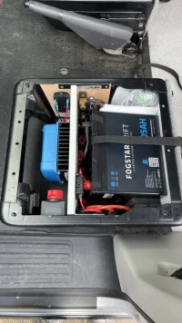

I have a swivel and my battery is under the passenger seat:
More of an issue if you are talking about a double swivel.
