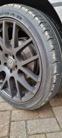

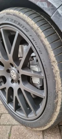

Just about to give the van a wash (a T32 Kombi 69 plate) and looked at my tyre size and ratings,
I bought the van in December 2022 from a VW dealer in Dorset, I know the history of the van shows VW lowered it (changed the springs), refurbed the wheels and replaced the rear two tyres prior to me buying it.
Are the rear tyres (98W) grossly under rated?

@murphyabu - Oli from @BognorMotors in post 32 gives the answer:
You are uninsured with these tyres. They need to be 103 for a t32. Your axle rating reflects this.
It really is that simple.
Just to update, I provided a detailed explanation to the dealer based on commentary here and a couple of useful websites and they have agreed to have the tyres replaced within the same day, really impressive.
