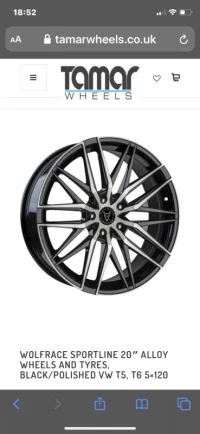

Anyone running these Wolfrace euro sport wheels?

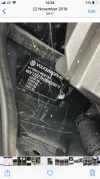

1680 divide by 2 = 840kg per wheel.
Therefore a 102 tyre will make you legal.
100= 800kg
101= 825kg
102= 850kg.
Clearly a difference between the rating of the axles on a T5.1 and a T6 (T32). Because on the T6 T32 the highest rated axle is 1720kg, which is what brings about the 860kg per wheel and a 103 tyre.
@bully85
100= 800kg
101= 825kg
102= 850kg.
Or in simple terms.... you lucky git!! Loads more options with 102 rated tyres for t32.
My factory T32 kombi is a T6, the axle weights are different. Don’t think “factory” has anything to do with it. VW must have changed the axles/ safe working load between the 5.1 and the 6
Alot of the t5.1 t32 panel vans have the 1720 on the rear but i have found that the t32 kombi on some have the lower one.no idea why
