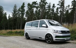

Was looking for some pics of the Fin model in Stardust. They seem to have good load ratingWe fit loads. What model wheel?
